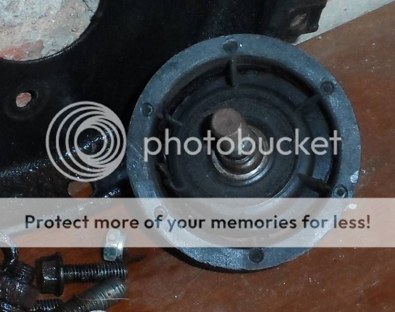

few pics of belt that let go and what caused it
Head is almost off now, put a camera in and valve's are bent _________________ P4 33......Fratellino (black)

2 bolts are stuck on the head, pic of the failed bit

Posted: Thu Sep 18, 2014 12:11 pm Post subject: |
It looks likely that the tensioner pulley bearing siezed, and then the pulley was cooked by the heat generated by the belt sliding over it.
Fitting a metal pulley would not save the engine in that case, as the belt would eventually overheat and break anyway.
Easily removable covers to allow frequent visual inspections might be a good idea. _________________ Dick Flower, Nr. Carcassonne. '94 Trofeo 1.4 ie (F), '93 Imola 1.3/1.4 ie (now for breaking) (F), '91 1.7 ie (GB)(spare car), '86 Sprint 1.5 QV (F). '87 VW Syncro camper (F), '73 NSU Ro80 (F), '99 Fiat Seicento (F) |

Posted: Fri Sep 19, 2014 1:54 am Post subject: |
Just to be clear, it was the idler that failed, the belt then rubbed through the plastic cover and snapped _________________ P4 33......Fratellino (black)

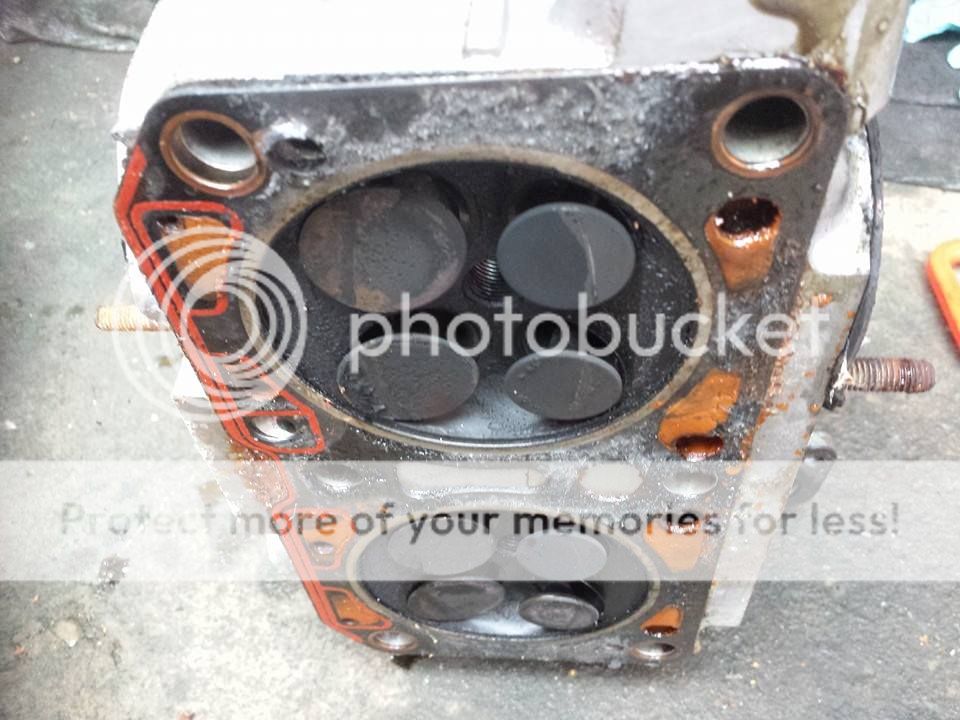

Head is off, 8 bent valves

The damage
Stripped

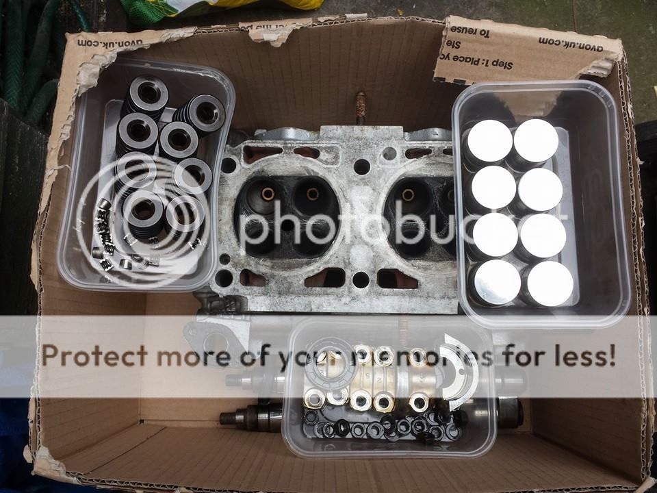

New shinny bits
and found some other stuff

nice bits
i am interested, where did you get new Exhaust valves? a bit rare thing  _________________ 146 1.6 & 1.7 16v boxers |

| niaugi wrote: |
nice bits
i am interested, where did you get new Exhaust valves? a bit rare thing  |
Valves was in a box of parts that came with the car 2 years ago
I Have found most parts via a few people, like Alex and happy to list or help people who need parts advice _________________ P4 33......Fratellino (black)

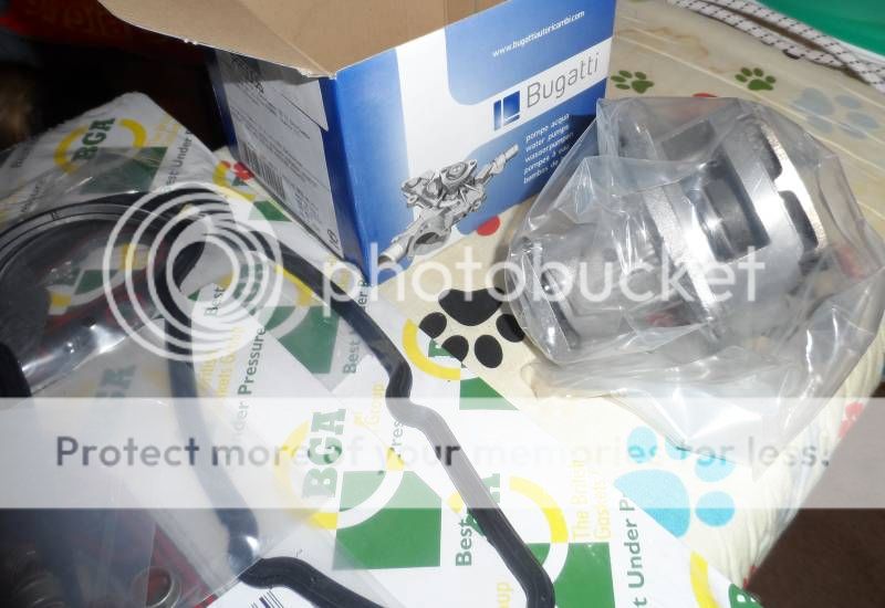

More bits
