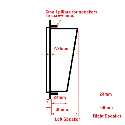

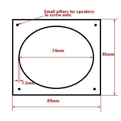

The late series 3 33 uses some very small standard front speakers, and despite hunting round I have failed to find any which match up. I think they are 8.5cm square. Some late cars were fitted with small adaptor cones to take alternative speakers, and thanks to Ian Watkins I now have a pair of these with speakers to replace the duff standard items in my P4. It should be possible to make up a couple of these brackets using plastic sheeting (Plasticard used by model railway people). Below are a couple of dimensioned drawings (although they are far from to scale). Note that the cone on one side is different to the other side.
The speakers in the pair I now have are Sony's. They are marked as XS-A82P.
