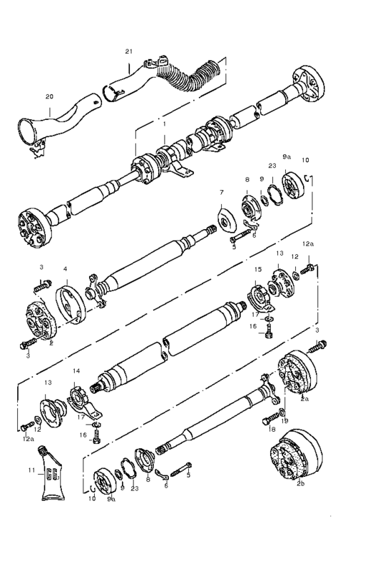

Posted: Tue Mar 20, 2007 9:46 pm Post subject: |
| Quote: |
| The front rubber mounts are slightly cracked but solid thankfully - I understand these are not available anywhere which is worrying. If anyone has a seconhand set in reasonable condition I'd like to purchase them - and perhaps see if I can find a source; maybe Panda 4X4 mounts or (Probably too big) but Vw Golf or even T3 Transporter mounts as these are all Steyr Puch systems too. |
Doesn't look like the Golf Syncro 1991 is going to yield a suitable substitute for the front viscous mount 60572375
[url] http://i51.photobucket.com/albums/f357/tempra/106100.png [/url][/url] |
