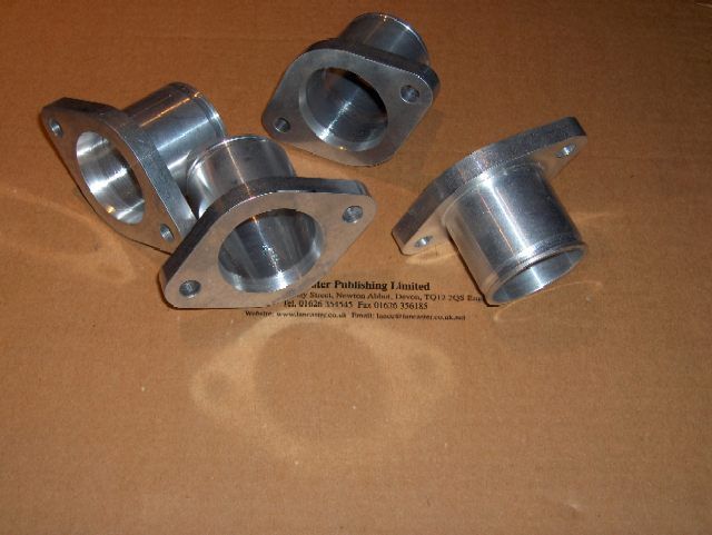

Just took delivery of these bad boys
now to get some nuts and bolts and get the 60mm trumpets milled down to 40mm such a waste. _________________ x2 33 16v
